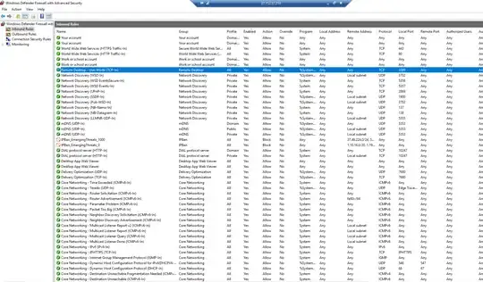

I would like to block all possible routes of access by only allowing Autodesk Vault, which communicates over HTTP(S) at port 80/443 (I'll likely configure it so that only HTTPS is allowed), and remote desktop, which I need to manage the server. But looking at the Windows Defender Firewall default rules, there are tons of open ports as default configuration. I find this a bit strange on a server OS - I want it to block everything that I don't explicitly allow. Can I safely disable all of these except RDP and HTTPS? Does it help? Have I missed something else obvious in my server hardening procedure? Screenshot of allowed services in Windows Defender Firewall

First of all, reinstall the server, because :
  1. This one might be compromised and can't be trusted anymore.
  2. Windows is secure by default, and maybe someone lowered the security settings of your server, hard to tell if there are no documentation.
You can take a look at this canonical question: How do I deal with a compromised server?
Check the Windows Security Baselines too, Microsoft updates them regularly.
About the firewall rules, you can export them first :
Export firewall policy
If you don't need RDP, remote management, remote powershell,... it's safe to disable or delete the default rules (ensure you can access the VM console first, if you remove everything you won't be able to connect using RDP) and create the rules that you need.
Swisstone
  • 7,063
It is possible to disable quite many of the services that are allowed through the firewall by default, without affecting the capability of hosting an Autodesk Vault server. I disabled those that I was sure that I didn't need - it's probably possible to disable quite a few more, with some research and/or trial-and-error.
Referring to the list of services allowed through the firewall by default, at the end of the question, here's a list of services that I didn't disable. All the others from the original list are disabled, without any noticable side effects. I also disable remote desktop, and temporarily re-enable it when I want to work with the server.
