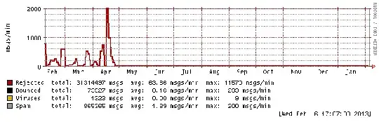

I use this this fake MX (a variante of the nolisting) and it works very well.
I used a postfix MX with all the usual filters and after some spambot manage to overload the server for 2 or 3 times i decided to give it a try...here is the result: fake-mx, before and after
try to guess when i have implemented the fake-mx! 8)
The result is the same as postgrey, but unlike postgrey, you don't need to change your mail server
The spambots now will either try the high MX or the low MX, freeing the real MX from the load of trying to filtering then (even with DNSBL, the load was high) and real email arrives with minimal delay.
