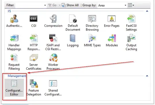

Just to double check, do you have logging set to error_reporting = E_ALL, and display_errors = On in your php.ini? Usually this is enough to display these errors in IIS 7.
Next, take a look at your IIS settings, as it may be set to only show error messages locally. In the IIS 7 configuration editor this is under system.webServer->httpErrors. You will need to change errorMode to Detailed from DetailedLocalOnly. Obviously this now means anyone browsing your site will be able to see the error.
Alternatively, if you want to keep them local you can use Remote Desktop to log in to the server and run the app from there, if you can.

Just wanted to add, that "existingResponse" should be set to "PassThrough". I didn't get any real error messages without that additional setting.
Bolli
  • 21
I tried these and it did not work. Specifically "Configuration editor" I needed to keep "existing Response" to "auto".
However I found that if you use FastCGI you need to go into IIS manager -> default web site -> FastCGI-> then select c:\php\php-cgi-.exe and "edit..".
Under "Standard error mode" you need to change ReturnGeneric500 to ReturnStdErrIn500
This will display the PHP errors if you have them turned on in PHP.INI or through settings in PHP code.
