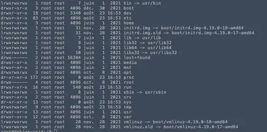

rm /*
In my case, I ran rm /* without -rf option on a Debian 10 server.
A bit less critical, but not too far .
System is still alive but many things are broken.
  • Mostly all commands are unavailable in my command line
  • I can not open a new SSH session
  • But, astonishing: my services are still running (docker, ssh, ...)
If I restart the server, I won't be able to login.
It would run in recovery mode.
panic mode
I've made all my tests on an equivalent case on a local VM to check my operations.
The point is that all symbolic links and files on / path are deleted.
Fortunately, all directories looks untouched. (that what has saved the situation )
Detailed road back to operational
Here are my detailed steps to get back to my machine with a runnable status.
  • Start server with an Ubuntu ISO to get a terminal from a bootable CD.
    Debian should work also.
  • Boot on CD.
    Do not install it, just use try mode.
    grub try ubuntu
    In my case, I'm using french keyboard ⌨ and I went through many keyboard issues.
    So, I decided to install openssh temporary server to run all following steps via SSH connection . For this, you can
    • open terminal (Ctrl+Alt+F3 / password: ubuntu)
      and type sudo apt-get install -y openssh-server
    • Customize password, with passwd command
    • Then, I was able to connect to ssh ubuntu@my-ip
      Get IP by typing ip a
    • and then, with sudo -s, I was back again in root mode in an efficient way
  • Mount harddrive on /debian path.
    mkdir /debian
    mount /dev/sda1 /debian
  • Here is the tricky part: you have to compare your /debian subdirs with a equivalent system.
    On basic Debian 10.11 setup, here is default structure : default debian structure.
    In my case, I started with following
    • main directories : bin, lib, lib32, lib64, libx32 and sbin
    • vmlinux and initrd.img files
    For this,
    • go to /debian dir with cd /debian
    • then, use syntax ln -s ./usr/bin ./bin.
      Relative path are required.
    Have a look on script section below, it can help
    From this, first reboot try. (hardware reboot, with CD removal).
    But, fortunately, it starts again in normal mode
I've declined this on 3 test VM before running it in production. I've tested Debian 11, Debian 10.11 & Ubuntu If your on a virtual system, you may run a snapshot on broken server before running these steps, in order to get back if things go worst.
I'm running tests for a few hours now, but it looks 100% operational and back to previous settings.
You can breath again
Script
For fast deployment of these steps, you can use my script on linux-rm-all-recovering.sh.
wget https://media.gtnapp.com/it/linux-rm-all-recovering.sh
bash linux-rm-all-recovering.sh
