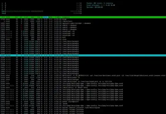

The server worked for some hours, and then broke again. I edited the file again to leave it as it was, and restarted again php-fpm (service php-fpm restart) but no luck: the server worked for a few minutes and back to the problem over and over. The strange thing is, although the services are running, htop shows there is no CPU load (see image) and I really don't know how to solve the problem.
