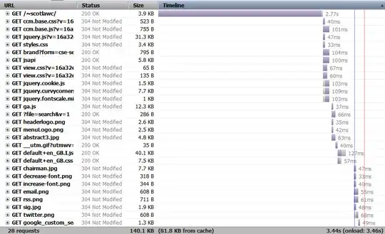

I've recently moved a client's website (using the concrete5 CMS) over to a VPS running Gentoo, Apache 2.2, PHP5 and MySQL 5 and I've noticed that Apache response times are pretty bad (it was the same on the old server), sometimes way up to 8-9 seconds, but more often between 300ms and 3 seconds (towards 300ms I don't mind). I know it's not network latency, since the server has a ping (from my location) of around 30ms.
Here's an example of the times (you can see it's snappy after the initial wait):
Firebug Net panel timeline

Do you know exactly what the apache worker processes are getting hung on? Try this to see:
mkdir /strace; ps auxw | grep httpd | awk '{print"-p " $2}' | xargs strace -o /strace/strace.log -ff -s4096 -r
Load a few new (i.e. not locally cached) pages in your browser, CTRL+C to stop strace then sort the strace.logs by time spent on each call:
for i in `ls /strace/*`; do echo $i; cat $i | cut -c11-17 | sort -rn | head; done
View any strace.logs with over 1.0 second calls and search by the time from the output of the previous command. This will point you to the exact step they are getting hung on.
Do you by change have a firewall like CSF installed? I saw this same problem on a VPS. When debugging httpd processes with strace it was taking up to 5 seconds or more on gettimeofday calls. Strangely I narrowed this down to CSF, which was trying to filter the venet0 interface, a loopback interface in OpenVZ or Virtuozzo containers. Setting this parameter in /etc/csf/csf.conf mostly fixed it for me:
"ETH_DEVICE_SKIP = "venet0,lo"
I say mostly because sometimes there still is 500-1000ms wait for connections to establish but it's a big improvement from 5000+.

You have to pull apart network, apache, mysql and php as sources of the latency.
If you can pull an image from apache quickly (very low time to first byte), then the network and apache are usually fine.
If you can pull a page with just a phpinfo() statement, then usualy PHP is ok (may need a few tweaks).
If you write a simple DB connection test and it is fast, then that layer is usually ok as well.
Lastly, pull the application page. If it is slow then the problem is internal to the applications processing. While tuning may help, this is far more difficult to resolve.
Without profiling the application, it can be difficult to find the problem. Tools like NewRelic can help with this issue but is not a cure.
Does your app have any type of internal debugging to show where time is being spent?

i suggest adding a rendering time measurement and checking how long it takes the server to render the pure HTML page. Then you know if its in the CMS or elsewhere. I bet my 2cent its not your server config. /maddin
