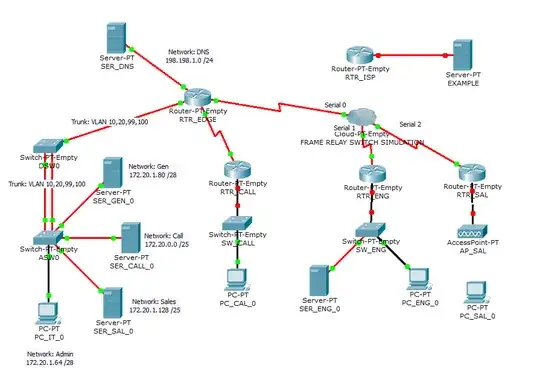

I have the following set up in Packet Tracer:
I am trying to configure frame-relay between the RTR-EDGE router, the RTR_ENG router and the RTR_SAL router using a frame-relay switch simulation (the cloud). I have used the following commands:

And the circuit appears in the map of each router:
RTR_EDGE#show frame-relay map
Serial3/0 (up): ip 172.20.1.109 dlci 101, static, broadcast, CISCO, status defined, active
Serial3/0 (up): ip 172.20.1.113 dlci 102, static, broadcast, CISCO, status defined, active
However, neither of the three routers can ping each other? Does anyone have any ideas as to why not? I have looked at a few tutorials on the internet and their commands are the same as mine, however theirs works and mine doesn't..

Your endpoints are on a different subnet to each other, if you decrease the subnet mask to a /27 (255.255.255.224 in non-CIDR terms) you should have more luck.
