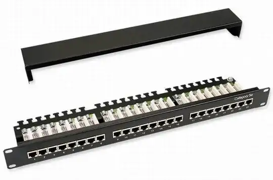

This is a patch panel:
alt text
From Wikipedia:
A patch panel or patch bay is a panel, typically rackmounted, that houses cable connections. One typically shorter patch cable will plug into the front side, whereas the back holds the connection of a much longer and more permanent cable.
The assembly of hardware is arranged so that a number of circuits, usually of the same or similar type, appear on jacks for monitoring, interconnecting, and testing circuits in a convenient, flexible manner.
Regarding your question about what's the difference between a patch panel and a switch: a patch panel has no "intelligence." It's simply used for connecting cables.

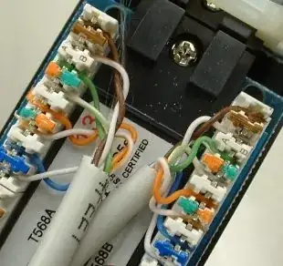

The counterpart to a network jack!
If you have big networks, you use CAT5e & CAT7 wires which are thicker than patch wires. From the Jack to your notebook, you've to use a patch wire.
To connect every network cable to the core switch which comes from the network jacks you need a big "panel" to patch the wires to the switches. That's the patch panel.
The inner life of a patch panel is similar to a network jack:
inner patch panel
Patch panels are there to deal with big masses of cables!
