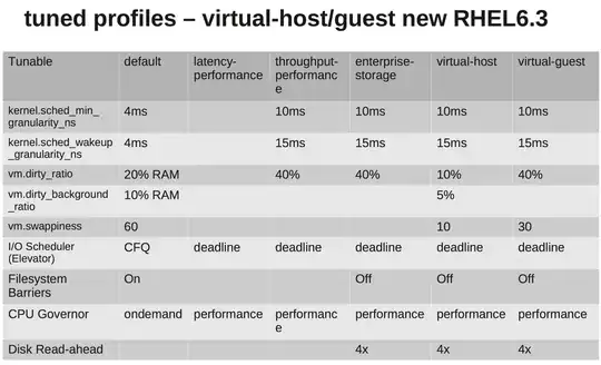

You didn't provide the version of CentOS installed as your VMWare guest... but let's assume it's CentOS 6.x.
The default CFQ I/O scheduler is a poor choice for guest virtual machines (and most systems). You'll want to modify it. I used to just recommend setting the scheduler to deadline, but there's an easier method now for RHEL/CentOS systems...
The best way to handle that and a couple of other tunables is to download the tuned framework and apply a better profile to the system.
In your case:
yum install tuned tuned-utils
Once installed, try one of the appropriate profiles. For VM's, I either do enterprise-storage or virtual-guest. Test and see which works best for you. A reboot is NOT required between profile changes.
tuned-adm profile virtual-guest
The reasoning:
