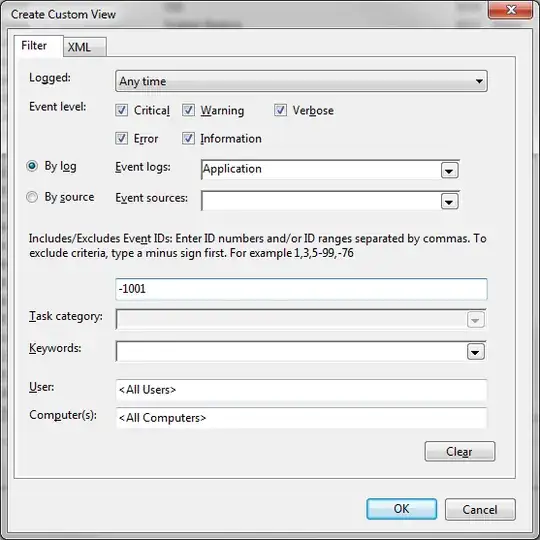

You can't stop logging for a specific event ID with the means of Windows, however you can change event viewer filter settings so that some items are not displayed if you want to, i.e. to create Custom View.
