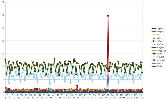

Sun Jan 6 21:00:07 2013: xvda w_await spike
xvda Chart - The w_await spike is at Sun Jan 6 21:00:07 2013 enter image description here
