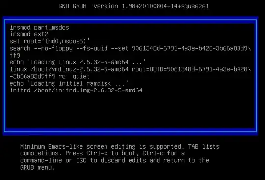

I forgot my root password and am attempting to change it by booting into single-user mode, however when booting I get this screen:
Then I press "e" to edit the boot configuration and I get this screen:
However, in the tutorial I'm following it says I should navigate to the line that starts with "kernel", but as you can see, I dont have this line. So I tried changing "quiet" to "single" on the line that starts with "linux /boot/vmlinuz...." but this doesn't boots the system into single-user mode.
What line am I supposed to edit in order for this to work?

  1. First screen - grub - press e
  2. Modify kernel line: add single between ro quiet and at the end of this line add init=/bin/bash
  3. Press F10
  4. When the prompt is root@(none):/# you have to remount the / partition to have read-write access: mount / -rw -o remount
  5. Now you are ready to modify the root password: type passwd and change it!
Good luck
P.S: try to look at the /etc/shadow file to find other users...

One method:
  1. Append init=/bin/bash to the end of the grub line which begins with linux (and ends with quiet).
  2. Reset your password and reboot normally.
  3. Don't forget it again.
  4. Consider installing sudo.

Your tutorial refers to Grub (legacy Grub). This is Grub2. The line beginning with linux would be the kernel line in Grub.
