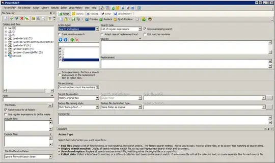

PowerGREP will do what you need. They include a 15-day trial, but it is for 15 days that you are actually using the product, so its quite a nice trial.
Once you start up the program there are two drop downs beside each other; 'Action Type' and 'Search Type'. Change Action Type to 'Search and replace'. Change 'Search Type' to 'List of Literal Text' or 'List of regular expressions'. You can add and remove Search/replacement Pairs.
http://www.powergrep.com/index.html alt text
(source: biffis.com)
