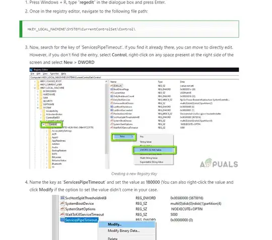

Please find a visualized answer by appuals.com
