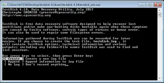

Create log file
Select Create (using Enter key) to create a log file

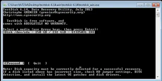

Select disk
Highlight the broken disk using the up/down arrows and select Proceed

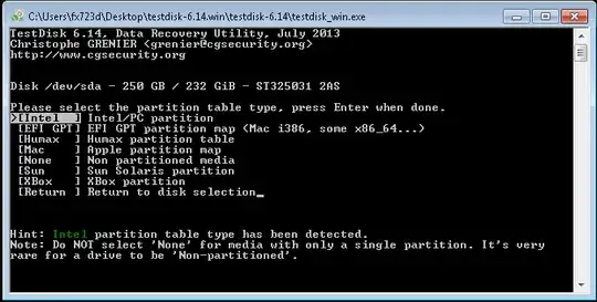

Select Intel
Select Intel

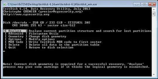

Select Analyse
Select Analyse

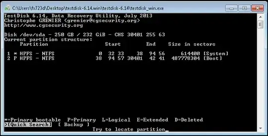

Select Quick Search
The "current" drive structure will be show, select Quick Search to find the correct drive structure.

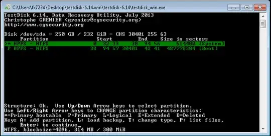

Select continue
This screen may take awhile to load. Here the detected drive structure will be shown. If you'd like you can select P to view the files on the selected partition. Select Continue from this screen.
