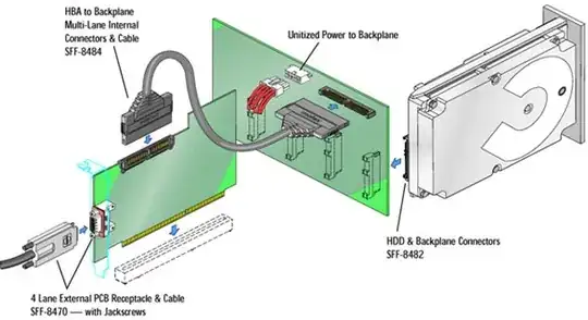

  • It is unlikely that your controller is bad or needs replacement. Plus, being an E200i, it's on your motherboard, so it's not easily replaced. Your disks are connected to a backplane, so a bad slot == a bad backplane, not controller.
