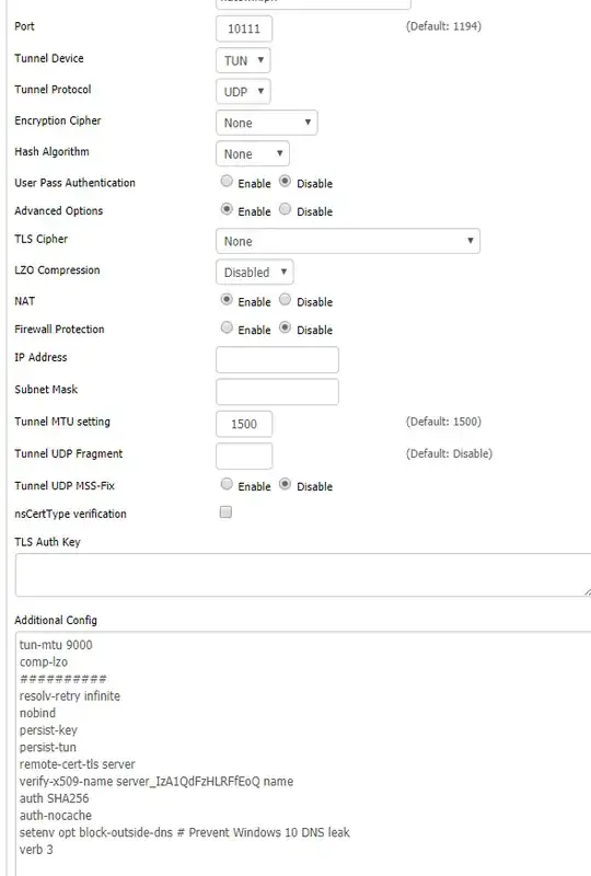

For me I had a VPS server with openvpn server setup in Japan and my client connection was using a DDWRT in OpenVPN client mode in NYC. I was getting only 1-2mbps on a 100mbit connection. The best I was able to optimize it for was 5mbps which was enough for what I needed which is as optimized as I can make it I believe.

My DDWRT OpenVPN client settings also seen in my screenshot:
tun-mtu 9000
comp-lzo
resolv-retry infinite
nobind
persist-key
persist-tun
remote-cert-tls server
verify-x509-name server_IzA1QdFzHLRFfEoQ name
auth SHA256
auth-nocache
setenv opt block-outside-dns # Prevent Windows 10 DNS leak
verb 3
