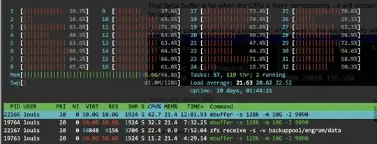

After doing zfs send tank@datasnapshot > /dev/null I realized I wasn't going to saturate my 10Gbit network anyway, so I decided to just let the backup pool to use zfs set compression=gzip.
The numbers turn out to be similar.
It's pretty rough on the CPU, but using mbuffer helps greatly.
sender: zfs send -v dank/data@snapshot | mbuffer -s 128k -m 10G -O s2dna:9090
receiver: mbuffer -s 128k -m 10G -I 9090 | zfs receive -s -v backuppool/engram/data
That large buffer is for when the CPU is busy compressing... it will occasionally get full, so this could be larger.
Overall I'm satisfied with the throughput, which was in the double digits without mbuffer: bmon throughput for zfs send with mbuffer
cpu hates gzip
