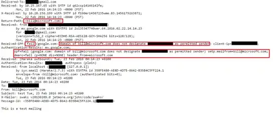

You can send your clients mails from bill@microsoft.com. The message will get to their inbox without any warning! (Microsoft does have -all in the spf record)
Checked and verified. Example attached.
this message went to the inbox.gmail Show Original
