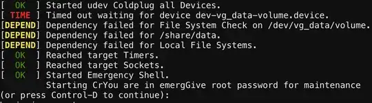

I am using Arch Linux and want to mount my two disks, /dev/nbd1 and /dev/nbd2, at the same mount point.
I created the mount at /share/data and added the following to /etc/fstab:
/dev/vg_data/volume /share/data ext4 defaults 0 1
Where vg_data is an LVM volume group.
I can mount it manually without a problem using mount /dev/vg_data/volume /share/data, but once I reboot the server it boots into emergency mode with the following output:
error
What is wrong?

UPDATE:
I just removed the entry from /etc/fstab and rebooted the server. As expected, the server booted normally, BUT /dev/vg_data no longer existed?
I don't know what is going on.
