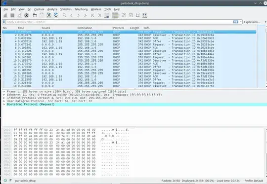

Wireshark screen-shot from DHCP Server capturing all traffic from client ether address.

Update Jan 14, 2018 I tried rebooting the switch, and physical server. Still no change. I then assigned the server it's own physical NIC / Switch port. Still no change. I then reviewed the switch configuration, and re-applied the port settings to the port being used, and the flood seems to have stopped. I am not yet convinced, and will monitor for a couple of days.
