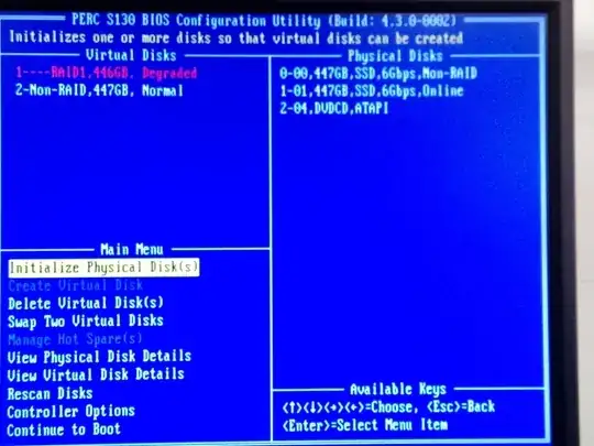

When Ubuntu finished setting up and the server rebooted, I went back to the PERC S130 BIOS Utility and it now showed the original virtual disk as degraded. There was a new virtual disk too that consisted of only the first hard drive, which I'm guessing Ubuntu made. (Obviously I'm guessing this is a byproduct of the above installation on sda). Perc BIOS utility after install

The S130 is a software RAID solution that needs OS drivers to support it. I believe that it is only supported by Windows OS and according to this RHEL7.2/SLES11/SLES12. This is why your Ubuntu is seenig the disks as JBOD.
As @Zoredache says you may as well just use an Ubuntu based software RAID solution configured during installation.
