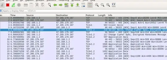

I don't think it's related to the certificate, as a raw openssl connection takes up to 5 seconds to connect, and then returns very quickly; https://hastebin.com/ejipapehux.rb
$ openssl s_client -connect environmentaldashboard.org:443  -CAfile /etc/ssl/certs/ca-bundle.trust.crt   | ts -s "%.S"
depth=0 C = US, ST = Ohio, L = Oberlin, O = Environmental Dashboard, CN = 104.131.103.232
verify error:num=18:self signed certificate
verify return:1
verify return:1
05.800695 CONNECTED(00000003)
05.800967 ---
05.801019 Certificate chain
05.801060  0 s:/C=US/ST=Ohio/L=Oberlin/O=Environmental Dashboard/CN=104.131.103.232
it's taking 5 or more seconds to respond to the initial Hello, so I'd inspect the server and see what is going on;
Do you have console access to the machine?
