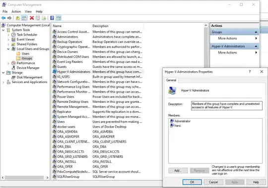

Go to:
Computer Management > Local Users and Groups > Groups > Hyper-V Administrators
and now add Administrator and any other user you would like to add
Now go to:
Start > VMConnect > Run as Administrator
and VMConnect can now see all the available VMs
