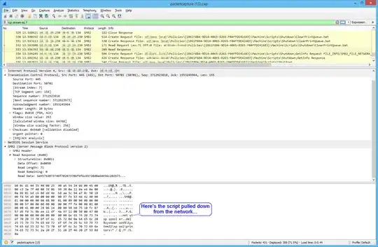

Further investigation using a packet capture and WireShark further seems to prove that the PC does in fact pull the script down from the SYSVOL share (why! It's right there on disk...) The time stamps correspond to when the computer was being shut down.
Wireshark packet capture showing how the script is pulled down from disk at shutdown time

It's by design. Microsoft never said that the startup/shutdown scripts will be executed when the computer is offline.
The local cache you found is not there for offline processing, but to avoid that the clients overwhelms the domain controllers. You can find more details about this particular point here: Group Policy Core Protocol: Cache of GPO Version
Additionally, the Group Policy Script Extension requires that the client must be able to validate the source of the script. And as you can see on the following diagram, the GP Server (Domain Controller) is the core of the Group Policy Scripts Extension:
https://docs.microsoft.com/en-us/openspecs/windows_protocols/ms-gpscr/ms-gpscr_files/image001.png
