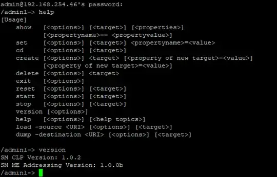

I have a PowerEdge R640 server. I was previously able to access the Web UI, but now I just get a never ending spinning wheel. I can ping the IP & SSH into it, but I'm not sure what to do once I'm in. Any suggestions on how I can access the UI again?
Web UI Screen Shot
SSH Screen shot
